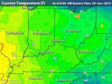

    Bear, I just checked the Ohio temp maps on Intellicast. Think I know right were dex lives now? :p

    When I used just the Quad for 3 seasons, Low was used until it got below 10° outside. Its only a 47,500 BTU unit. So the 43,000 of the P-43 will be plenty :)
    On the map, thats EXACTLY where I live. The corners of Ashland/Medina/Lorain counties. I can throw a rock to each county from my porch. ;)

    You really do warm the whole town/county don't ya! :p
    I got lucky then when I placed the dot. I read you worked in Cleveland near erie. I moved the colored dot down a bit and clicked. Photoshop can almost make it look real. I couldn't quite get the right font for the numbers. ;em All in fun bro-All in fun! ==c
