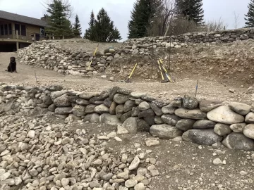

Interesting idea! I have poured quite a bit around the outside (walkways, patios) and you certainly start to feel the 80lb bags after a while. With the timing of the initial set (with a little delay additive), I can only work about 20 sq ft at a time (17-18 bags). Then wait three days to remove forms, do next section. So, it takes a while, but I am retired with time on my hands. Here are a few pics of the build site (been working on it most the winter, dry stone retains walls).
