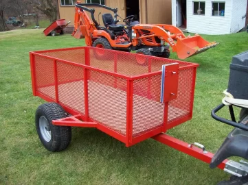

I had a need for a small, lightweight log trailer to fit into some tight spaces and still be manually moved about for loading and positioning. I couldn't find exactly what I wanted on the market so I took the time over the holidays to build this blue one.
I needed one that was small, lightweight and could haul 4-6 logs up to 8 feet long, and this is what I came up with. It needed to be low to the ground with removable side pegs, as I will be manually loading the logs onto the trailer. I know my limitations so I assume these logs will be up to a maximum of 15" in diameter or so, and cut to about 8 feet long. This trailer will handle them easily. The reason I wanted a trailer such as this is I don't always have the time to buck the logs during the felling operation and haul them out cut up. This trailer will allow me to load the logs out full size to my bucking & splitting area where I can buck them up when I have the time. I can then go out with just a saw and maul if I only have a couple hours to work, rather than getting all the equipment out and making a day of it. This trailer will simplfy the process.
It's built from 1/8" wall 1 1/2" square tubing with front tires & wheels from a Craftsman lawn tractor. The key to this trailer was to ensure it sits level while transporting the logs, so the gooseneck took a little layout time on the CAD system to ensure the height of the ball coupler vs the trailer deck.
This is the fourth trailer I built for hauling wood, three of them are pictured below. I now have a total of (5) small utility trailers (one purchased) I use around my home, each for a different purpose, of course all related to the gathering and scrounging of firewood!!
Two of the others I built are pictured below, they are the red trailers.

Low, strong, and lightweight, looks good. On mine I ripped some 6" logs and fastened them sideways flat side down so I could buck the whole trailer load at the splitting station.
+1 on this - highly suggest adding some higher wood bunks so you can cut your wood to length while it's on the trailer. You will eliminate a step in the wood handling (unloading the logs), and the wood should be easier to buck up while it's on the trailer rather than laying on the ground. A bucking stand on wheels.

Geez, those all appear to be nicely designed and built for wood moving tasks. As has been said, very professional looking too. I'm not thinking that blue one would be hard to sell at $300 or more. I can't weld/build like that and I'd bet there are a lot of others like me who can't, but who would appreciate your skills and those trailers. Nice work..
Also... really like the deflector braces in front of the wheels on the red cage trailer. Good protection in the woods...

AJ..Those wheel deflectors work perfectly, as they will skoot the trailer over sideways when hitting a tree, hit many so far!
Maple, I will try your suggestion sounds like a back and work saver!

Sweet! Hey- I'm sure that everyone has a mod to suggest (everyone's a damn expert)- but is there a simple way to also use it to hold a log for cutting off a round before unloading?
Wood bunkers under the load would make this a snap.
