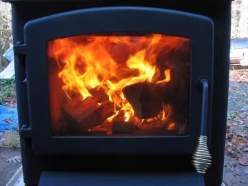

Got my used Englander 13-NCH. Starting it up outside using oak pallet wood, I can't get it to light without some smoke escaping through the door. I leave it slightly open, flame jumps up very nicely, a little smoke comes out of the door. I close the door, flame goes immediately down and it becomes smokey inside the firebox.
Is it possible to start without any smoke coming into the room? I tried crumpled up newspaper the first time and it made a lot of smoke. Soaked cotton balls in vaseline and got less smoke the second time.

The outside burning was about perfecting a startup technique that would assure no smoke. My wife is very sensitive to smoke. Doc C's comment is probably right. Burning outside is different from burning a properly setup stove. This is the second wood stove that I have used. The first was an old Vogelzang L'il Sweetie that was a box with a pipe. It lit easily and produced as much smoke as heat, but once I learned it's little quirks, it lit up with no room smoke.

Yes. Just cure it and install it. Even if you constructed your chimney outside exactly like it was going to be inside it still won't behave the same as it will once inside the envelope of your home. You are just creating work for yourself.

The stove will act totally different once installed. Since you are outside with a temporary setup there is no real pressure difference to establish a draft (its acting pretty much like a BBQ at this point). Let us know how it performs once installed.
