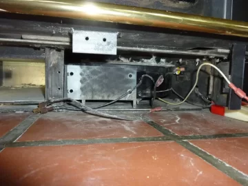

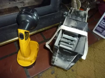

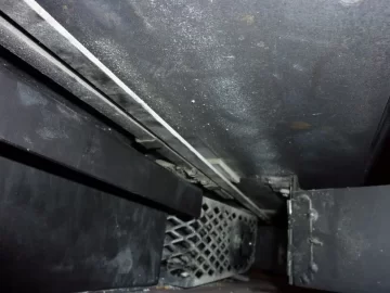

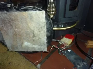

First pic is from the left front, showing the ash pan and expanded-metal panel that holds the rheostat and switch. Middle pic is with ash pan out and electrical control panel off. You can see the motor is still mounted and the insulation on top of it. Intakes air from the bottom, near the floor. Third pic, blower out. Fourth pic shows the blower snout and the gasket that goes around the end, where it pokes through into the convection jacket. Kinda hard to visualize until you start taking it apart.
Still going with webby's theory as the most likely, though..
