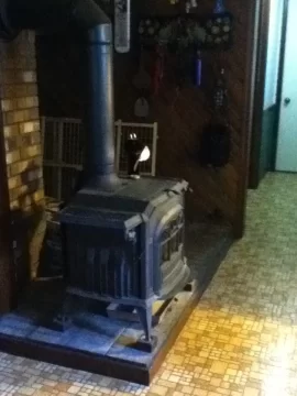

    From the OP's other thread, I think he had the Resolute rear-vented also, so worse than two 90s. It also sounds like he's got 15' from the thimble to the top, plus 30" from the stove to the thimble. If all this is true, I'd think a 6" liner/top-vent setup with the 45s would draw pretty well.

    Resolute has 1 \ 90 & is using the out the top option. My Fisher GrandPa has the rear vent discharge & 3 / 90's

    My space can't handle a larger stove than about 2.0 cu ft & even then it can't be deep
    Its in a main walk way & currenty I think the Resoute ain't kosher. Been their since 94 me, since 2005

    Yeah, that's not much of a hearth, but it can be fixed. Get the right stove for your needs and it will last a long time. The T5 will not be too much stove. It is a very flexible burner and has easy hearth requirements. You will really appreciate having the depth in the firebox. It's much more flexible for loading options.
    Is that linoleum or tile flooring?
    PS: When taking cell phone pix for posting, hold the camera horizontally or rotate them first on the computer. I'll fix this one for you.

    Linoleum soon to be replaced with a very hard waterproof laminate
    T5 needs 18" on front 7 " rear , if I remember correctly
    That puts it to far into the walkway
    T5 a deeper stove than the Resoute But can be placed 4" father back
    No love for the Rangley?

    I think the F50 would work, but you expressed concern about going over 2 cu ft.. That's why I asked about the F45. The PE T5 has a unique baffle and secondary air control that gives it exceptionally good burn times. With a lot less moving parts in the long run I think it will be lower maintenance. Another stove you might look at is the Quadrafire Cumberland Gap. It's a front & right-side loader in the 2.0 cu ft range. http://www.quadrafire.com/Products/Cumberland-Gap-Wood-Stove.aspx
    If you're replacing the flooring this is the perfect time to extend the hearth with non-combustible tile. With planning, it sounds like you might be able to do this so that the tile finishes flush with the laminate flooring. Or you could just nail on a hemmed sheet of copper or stainless as a hearth extension.

    Ask the engineer guy at that stove shop about putting tile down as a hearth ext as you said . Said I must put down a non comb under layment . That's gonna raise floor there at least 5/8" ??? Maybe more . Is there an under layment strong enough too replace my plywood floor in the hearth area

    He could be right if the laminate is only 3/8" thick. That is why I also suggested the metal. Or you could have the tile hearth extension rise about 1/4" above the laminate, framed in by a beveled surround that ramps the difference between the two surfaces. That could be visually quite nice with the right tile.
