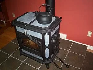

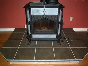

Really not much to add here but I agree with what has been posted regarding the Fireview. I am just finishing my third break in fire and am really impressed with the quality of the stove and the customer service I received. I replaced a soapstone Morso with this stove and was able to engage the cat for the first time today and can't believe how long the little bit of wood I had in there burned. I can't wait to see what it does with a full load.
With the rear heat shield your clearances are reduced but that also blocks the OAK hook up which I wouldn't use anyway.
The only things I would change about the stove would be a larger window and a more plain stove as I'm not big on the scroll work.
My decision came down to the Fireview and the Phoenix and although I like the looks of the Phoenix better, went with the Fireview due to never having heard a bad word about the stove or the company. I am happy with my decision.
I originally ordered (down payment) a stove about 3-4 years ago and backed out because of the cost. I was not pressured at all to continue with the sale. Their product really sells itself. I wish I purchased it then because of the high oil prices two years ago.
I finally got a Fireview last September. It is by far the best company I have ever dealt with. I must have called them between 100-200 times within a few months after ordering and when I was first learning how to burn. The craftsmanship is top notch. Even their surface thermometer is the most accurate I have found, which tells me that they have good quality control on incoming materials.
Anyway, this is my first stove so I can't really compare to other stoves but here are some of the reasons I like it and why I bought it:
• Requires no electric (great in power failure)
• burns half the wood with the catalytic combustor
• beautifully crafted
• can cook on it (power failure)
• simple to operate once you get used to your particular install circumstances (weather, chimney draft, wood type)
• built to last for at least 20-30 years(except replacing catalytic combustor) judging by posts from people who still use the original stoves.
• simple mechanics (compare opening a hood on a pre-1980 auto versus a newer). The Fireview is built the way older cars were, but uses newer cat technology
• Nice view of fire (on startup but especially when flames kick in from combustor)
• Did I mention the best customer service
• Much more
The only regret I have is using wood that was not seasoned properly for at least a year last winter.
Mike
