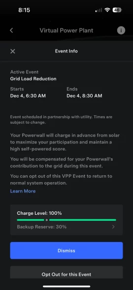

First grid event tomorrow morning at 6:30. First one. This means the power company gets to control my battery from now (not sure what time it was issued) until I guess my battery goes down to 30%. Says it will start at 6:30 AM ending at 8:30 and there are 83 fleet homes now up from 24 Friday. I’m guessing that about 0.5Mw for two hours.
So it’s pretty cool I guess. My battery would have been down to 30% before 6:00 AM anyway.

Second virtual power plat event scheduled for tomorrow morning. These things are non events as far as I’m concerned. My battery stayed charged 12 or more hours before discharging to the same soc as regular. So let’s say they do this 40 times at 10 kWh each time….
That works out to paying $1.56 per kWh!!! Or about 40x the base whole sale price. So am I leaving money on the table?

Seems like it, if your system can provide enough to meet that demand.

Quick loot at Ercot shows that 40x increases over base price are possible during peak demand. Which probably don’t happen 40 days a year. I’m ok with the simplicity of my involvement and the compensation.
