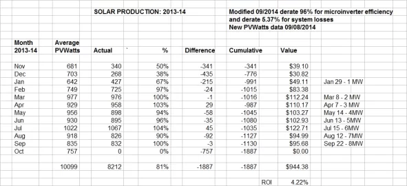

September finished well, falling short of the predicted average by only 3kwh. This chart uses new PVWatts data, the net effect of which from the prior data is to move monthly kwh amounts around a bit and increase total annual estimated production up about 1 MW to just over 10 MW. The big deficit months were Nov, Dec and Jan, and totaled 991 kwh. For Feb-Sept the total additional deficit was 139 kwh. With just one month go to finish the first year, it is obvious I will not meet the predicted annual average.

Yes. My first estimates were based on 2% derate, which was do to my ignorance. With each PVWatts data update, plus with what I have learned, I think my derates now are pretty close to actual. Last Fall and early Winter were extremely cloudy. Hence the low production. October is starting out with dense clouds and mist. Production today was 3 kwh!

Hard to believe that one full year of PV is in the bank. The market was "down" a bit, with an ROI of 4.58% vs 5.18% had the Average PVWatts production been met. The "loss" occurred primarily in Nov, Dec and Jan, with production falling short by 991 kwh, and the balance of the year failing to meet average by 182 kwh. No complaint, however, because the same money invested in a CD would have produced only about a 1% return on a one year CD. But, one year does not an average make, so on to Year 2 and wait and see what the outcome will be.

My current rate is $0.115/kwh. If the rate rose 10% to $0.1265, my return on the initial investment just jumped from 4.58% to 5.55%, a 21% increase. Incidentally, my utility just announced a rate increase in its interruptible power rate.
