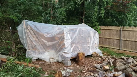

I finished my solar kiln today just before the thunderstorms moved on. I have a virtually unlimited supply of free pallets so I used them as much as I could. I have 2.20 cords on pallets, a little over 27 feet long in each row. Used wood for the center support and build a wide box on the pallets holding the ends up. I used rope on the corners to keep the plastic from touching the wood.
First time I’ve done anything like this. I hope it works out and this wood is usable sometime this coming winter.

Took a couple shots this morning after making my “grapefruit sized” gable end vents. You can see the string at the corners helping hold plastic away from the end of the wood.
It’s 100% humidity and cooler today, so I can’t really tell how well it’s working yet. Temps inside are 10-15 degrees higher than the outside air in full, heavy cloud cover. Lots of moisture on the inside of the plastic. Not sure if that’s good or bad.
I taped each gable end vent open about 1” after taking these photos.

View attachment 246273 View attachment 246274 View attachment 246276 Took a couple shots this morning after making my “grapefruit sized” gable end vents. You can see the string at the corners helping hold plastic away from the end of the wood.
With the holes in the plastic, no or minimum condensation should occur. I did it last year without holes and had a lot of condensation. As long as the moisture runs down the plastic and doesn't go back in the wood, you will be fine. However, the air inside will remain "wet" and with holes in the plastic it will remain a lot drier. I have holes in the plastic this year and "zero" condensation.
Thank you for this information. Makes me feel better. The thunderstorms yesterday hit right as I finished with the stretch wrap, so I did not cut gable end vents until this morning. Prior to this morning there were no holes. I noticed the condensation when I cut in the vents this morning (and took those photos in my most recent post of the inside).

Still cloudy, but temps inside are rising. Ambient temperature outside is 74 degrees and about 80% humidity.
Update:
The sun came out, and this thing is cooking now! Very excited that this might really season my wood in 3 months or so.
Good looking kiln and thanks for posting it. I wpild open the vents a little more. Mine gave been wide open sence i put it together on the 4th. One of the principles of the kiln is this. Even though you're at 80% humidity your Kiln is approximately 30 degrees warmer than the air temperature which actually is dropping the humidity inside the kill. Remember the warmer the air the more moisture it can hold which is the basic properties of the kill the hotter it gets the dryer the air is inside and therefore it will dry the wood rapidly.
As for the shrink-wrap question I put the shrink wrap around the bottom which is help holding the plastic where I want it. Which is at the bottom and not blowing around. You dont want the kiln to blow apart..
If you dont mined me asking.. what was the MC of the wood when you started the kiln..
Thank you! I appreciate your sharing this information, as I built this to mimic as best I could your plans.
How much would you recommend I open the vents? They’re open about an inch now. I am not sure how to correlate temps I’m seeing inside with how much I should have the vents open.
Also since I attached 2x4 runners along the edge of pallets so I could attach the plastic sheeting to them and keep them from contacting the wood, the “gap” at the bottom of my kiln is only about 1” or so most of the way around. Since it’s 27 feet long, do you think a 1” gap is sufficient if I keep it clear?
I just checked the kiln again since it’s been in the sun for a couple hours, and I can actually see the moisture running down the sides and dripping off the bottom of the plastic sheeting. So that concept certainly works!
It’s a mixed bag. About half is pine that fell in a big storm at the very end of last November (one hit my house, that was not fun). It was measuring about 38% moisture content when I bucked and split it (testing in center of fresh splits). Some has been air drying for a month or so, some was fresher.
The other half is a mixture of hardwoods. I found a storm-felled red oak that had been dead long enough for the bottom to be too punky to use, but the top was still fine. I felled some smaller birch and beech trees, and one 20” diameter red oak. Those have been drying for maybe a month before I put them in the kiln. Most of what I tested before putting it in was also in the 38-39% moisture content range.
I have all of the pine on one side and all of the hardwood on the other side so I don’t confuse them.
Try to keep your wood separated. Softwood will dry faster than hardwoods. I would check the pine at middle of September. You may be able to pull that out of the kiln. Than vhec the hard wood to see where it is.
I would vent the kiln alot right now and get the moisture out. Than close the vent a little. Like i said, mine are still wide open and i build some good heat in there..
Will do! I went ahead and opened my vents all the way up for now. How long do you wait to "close the vents a little"? A month?
I have the pine stacked all together on one end of the kiln, so it should be easy to get out of there if it dries early. That would be great! If I take it out mid-September, can I put more wood into the kiln or would that interfere with the hardwood continuing to dry?
Thanks for all the guidance @Woodsplitter67 . This is the first time I've done anything like this.
