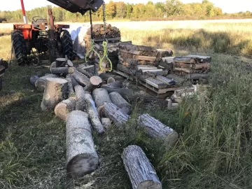

Update on this years kiln process. With the price of poly I looked for a less costly alternative and bought a case of 18" shrinkwrap and a roller/dispenser. I wrapped the pallets individually with a "cap" of 4 mil poly and shrink wrapped sides. I only needed just over a 50' roll of 10' poly and one roll and a bit of shrink-wrap to cap twenty two pallets with +/- 1/2 cord of 2' splits on each one. As I have indicated previously, my primary goals are well seasoned (15% or less) wood and minimal handling. With each pallet a stand alone kiln the splits are dried and covered until needed. I shift 5-6 wrapped pallets into the woodshed adjacent to the boiler room and take the plastic off as wood is needed. I only handle the wood twice; from splitter to pallet and from pallet to boiler. This year's wood is hickory, sugar maple and beech that had been down, in log length for about a year. Was mostly wrapped from mid July to mid August with a few later pallets done around the beginning of Sept. Moisture content on what I have been burning ranges from 8%-14% depending on species and location (top or bottom) in pallet stack. The later wrapped units are 17%-19%, still not too bad but I may not need them this year.
Pic is after the first couple of days of processing.
Do you know your plastic costs for those 22 pallets? That is 11 cords, a lot! I am curious how you do your wrapping. Is your wood stacked flat on top or rounded top? You put the 4mil poly on the top? How? You just wrap round and round the bottom with the shrink wrap? Wrap just one layer thick? Is all of this enclosed or is there any venting?
