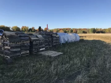

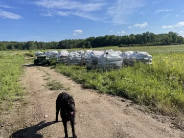

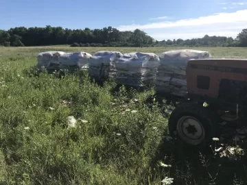

Do you know your plastic costs for those 22 pallets? That is 11 cords, a lot! I am curious how you do your wrapping. Is your wood stacked flat on top or rounded top? You put the 4mil poly on the top? How? You just wrap round and round the bottom with the shrink wrap? Wrap just one layer thick? Is all of this enclosed or is there any venting?
Single layer of 4 mil over rounded top, corners tacked with stapler to hold in place while I wrapped the sides. Shrink wrap overlapped about by half, so effectively double. One 10x50 roll and a little bit of poly; roll was about $40, one 18"X1000' roll of shrink-wrap and a little bit. I think the 4 roll case of shrink wrap was about $50, and the dispenser $25 +/-. One pic shows the first few individually wrapped this, second one the start of last year's 2-4 pallets in one kilns

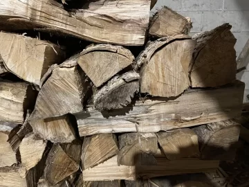

An interesting update: we brought another three skids into the woodshed the other day, one of which turned out to be somewhat problematic. This one contains primarily smooth bark hickory, especially near the top of the stacks. I thought the splits seemed a bit heavy but hickory is heavy relative to sugar maple or beech so it didn't concern me, then I found the boiler struggling to keep up with the demand for heat. Still didn't quite connect the dots until I threw in some maple this morning and the boiler immediately shot up to the shutdown point, then maintained temp with the outside temp at -10f.
So, this particular hickory tree, for whatever reason, even with its splits being at or near the top of the stack in the "kiln", only dried down to 18%-20%, as opposed to the maple at the bottom of the same skid that is at 10%-12%; go figure. In the two years that I have used this process I have never seen this type of discrepancy.

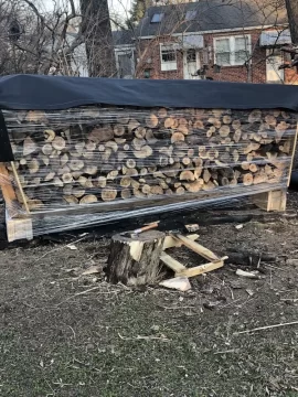

Experimental kiln. Pallet slats on all corners to make a void to build up heat. From the pic it looks like there are gaps but the pallet wrap is continuous apart from a gap at the bottom. Interestingly the wrap withstood substantial and sustained winds for a couple of days and it was the tar paper roof that got trashed by the wind. The wrap flexed like a spiderweb and accidentally I have wind activated venting. Will rebuild with better roof substrate. Wrap is HD 15”.
keep the top clear and.make sure you vent it right away. it's a little early to start the kiln.. how long ago was it split
