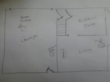

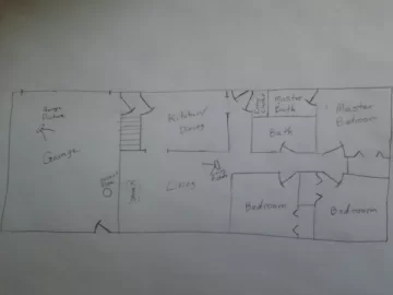

Ok lets see how this goes, trying to upload some photos. Just to explain, the first 2 are a quick sketh of the the floorplan of the house showing the current flue location and proposed stove location in the living room.

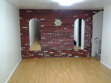

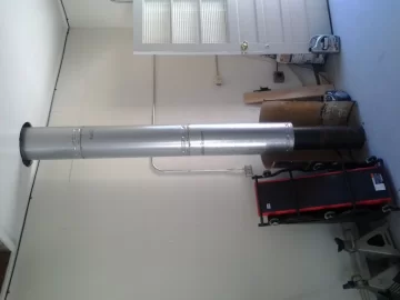

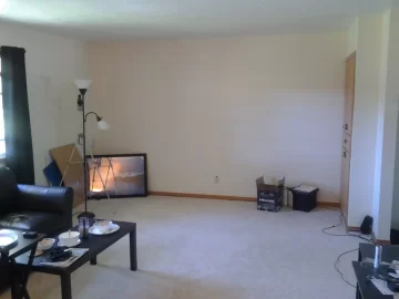

I also have 3 pictures of the current setup. One from the garage showing the current flue (sorry about it being rotated, i tried to correct it before uploading, but no matter what direction i had it, it uploaded like it is), one from the living room of the empty space for the proposed stove location, and one from the basement of the old flue outlet. This is right below the proposed stove location. The half of the basement that is finished is below the living room and the bedrooms to the right of it. The unfinished half (which has all of the water pipes, hot water heater, well, pressure tank, and washer & dryer) is under the kitchen, bath, and master bedroom

I am late to the dance here but here goes. No way two to a flue. Dying by CO poisoning really sucks. So does heating from a basement. The earth around the basement soaks up a ton of heat which is heat not going up and a lot of extra wood. It takes nine to ten hours before heat from a stove in my basement start adding to heat on the first floor. And I have some major firepower stove wise down there.
About pipes freezing. Using KC weather stats you have pretty much the same climate as we do. And our basement stays at 50 degrees minimum in the coldest weather including when there was three feet of snow on the ground for a long time.
