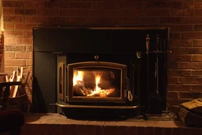

There are definitely stoves to be had on CL. All sizes and flavors. Lots of old ones but the EPA certified ones are harder to find. I searched for about 4-5 months but finally found one that suited my needs. Got this Buck Model 91 Cat stove for $500 just a couple of weeks ago. Because I had an insert already, I could take my time and be picky and it paid off for me.

That is a sweet fins, and a huge firebox!
Did you have to change the liner? Is it lined? or did you already have an 8" liner? They call for 8" don't they?

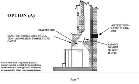

It does have an 8" pipe but right now it is what I have seen referred to as a "slam" install. Short piece of pipe extending up into the fluebox. The Buck manual shows this as one of the options.
I'm new to the world of liners and such and don't really understand the advantage of them when you have a chimney that draws very well as mine does. Do they make the stove more efficient. Right now it is going into a chimney that is 11"x11". I read somewhere, don't remember where right now, that a liner wasn't needed if the area of the chimney was less than 3x the area of the stove pipe. 8" pipe is 50.2 sq in. and chimney is 121 sq in. If anyone can shed some light on this or point me to a thread or article, I'd appreciate it. I may post this as a seperate thread sometime as I'm confused as to the need/purpose of a liner.

Yes if the cross sectional area of the tiled flue is too large is may draft poorer.
The main advantage of lining if not just needed to meet code, is you don't have to pull the insert out each year to sweep the chimney.
With your "slammer", you should be pulling the insert each cleaning, to get everything out that is swept down. Not a fun process.

Thanks, pulling the insert isn't too big of an issue. Even though it weights in at about 600 pounds I can move it fairly easily because I put a bunch of BB's down when we installed it and it rolls back and forth. It takes some effort but not anything like trying to move it across plain brick.
