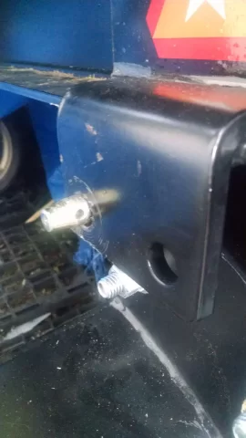

Second time using country line 28 ton splitter 3rd issue. No cotter pin in main pivot. I did not double check it beforehand and the splitter almost did a cartwheel. In hindsight I know I should have inspected it closely after already having issues with machine but WTH it's a brand new machine. [Hearth.com] Splitter Advice
The swirls in the paint tells me that it originally DID have a pin in it. It must have got dislodged somehow. Hair pin style pins are notorious for getting yanked out by things like branches and weeds.
Sure do.
I usually try to tie a piece of wire to something from the pin loop, so if the pin falls out at least it hopefully won't get lost before I notice it dangling from the wire.
Another semi-related tip: if you have a trailer jackstand that is removeable & held in place by one of these pins, take the jackstand off & put it in the back of your truck when you're moving the trailer. Nothing much worse than getting where you're going & finding your jackstand has mysteriously disappeared.
Looks to me like there was something there. I'd suggest getting a locking hitch pin. They can be found at tractor supply or somewhere similar.
Swirlly paint is from deck screw I put in to finish the round that was lodged on wedge. I plan to keep the splitter but I could return it. I do not recommend the country line 27 ton. I would go for the 22 ton. I also don't recommend the 4 way wedge.
