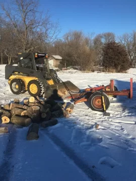

This is what I run currently..we can crank out a cord a hour pretty easy. This is my actual splitter that they built for me and they used it to shoot their info commercial.
