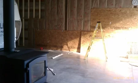

I studded out the walls between my poles and built a proper FG batted wall just like a house. It is not expensive to stud the walls out. You can buy very wide fiberglass batts too which will allow you to minimize or eliminate the additional framing. But really, you want to add a surface anyway so having those studs provides a place to attach the sheeting on the inside.

Correct. No gaps. Look at my framing work, this is a job done as well as possible. If you hire this job out you may not get as good of a job. The spray foam is superior for sure but wow, the cost! If you properly air seal the wall then the only losses you have from gaps are the actual loss of R-value on that gap. If you miss 30% of the wall then you're an idiot. Start with properly spaced framing members. Like I said, you can buy wide rolls of FG, like 8' wide for cheap. Pole barn companies (Morton) sell them.
On top of those batts with VB stapled for an air seal, I installed the OSB with sealed edges, that's right, caulk all around. The ceiling has 6 mil plastic sealed and overlapping the wall batts two feet. Then R-50 cellulose blown in on top of the metal ceiling, I think it was 158 bales, brutal. The real problem, the only thing you can't fix, is the overhead doors. Those buggers are the enemy of an air sealed project.

The batt VB is stapled to face of stud, then overlapped by the next batt's VB and stapled. That double lap is on every millimeter, and then the OSB is screwed tight and sealed which compresses the double VB below it to make it air tight and the OSB itself is air tight for yet another barrier. This is all for air infiltration, not for R-value. If you didn't think that you had enough skill to properly attach the batt's VB then you could instead cover unfaced batts with plastic as is common in Canada. Air seal is more important than R-value, get it right. Then R-value can be done many ways.
