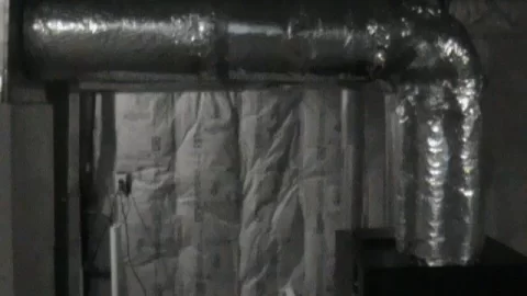

I will post a pic later tonight. We took our time wrapping it, so I think it looks OK.
What did you use , fiberglass?, or foam? just wonderin'?
The attached is fiberglass duct insulation. I got it at Home Depot. It has a silver backing as you can see from the attached.
