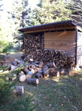

This year because of work i am way behind in my firewood cutting and had to buy 8 ft wood ( Maple ) that i am in the process of cutting into 16 inch long firewood . This will be wood for 2017-2018 burning season .
I have a shed that holds 7 cords .Its 8x16 and i stack 7 feet high . No front door on the shed .
If i stack 5 rows of fresh green wood in there do you think it will be seasoned enough for next year ?
The shed is 8 ft high in the front and 7 ft in the rear .
I sure hope so because soon there will be too much snow around there to get any work done and thats why i am considering piling my wood right away in my shed .
Soft maple might be burnable by next year if you split small, leave space in between stacks and it gets some wind movement. I doubt it will be optimally dry though. Hard maple, forget it, won't be ready.
It's hard maple . I'm thinking of removing a few boards on the shed on the 3 other sides maybe every 2 feet to get more air flow . The last foot of the 2 long side is already open . Even putting a few hinges on these boards to use again if this situation should repeat itself .

This is my shed the last time i filled it a few years ago . That time with a mix of soft and hard wood .

Sweet shed. Just think it's a losing battle with hard maple. What's the problem with stacking outside and top covering. will dry much faster that way.
We have long winters here in Canada and i have limited time to enjoy my firewood cutting. We use between 7 to 10 cords of wood every year and i'm just trying to speed up my process without sacrificing quality of firewood .
I think outside in spaced stacks & top covered will do a lot better than sandwiched in the shed. Doubt hard maple will be ready for next year either way - or won't be much better than marginal. Doing stacks should speed things up too vs. stacking in the shed.
If you've got a place to stack...
I dunno know about hard maple. spruce would be iffy as described in the shed pictured and birch, no way.
Most of this wood is already in the shed by now . What about if its in there for 2 years . That should help imo .
Bottom line is green wood needs air movement around/through it. That's a real nice shed but I doubt much air moves through it, especially with all the trees around it. Plus if it's stacked tight, the wood on the inside won't get any air. There will likely be some drying, but it will be a very slow pace - years with hard maple. And there might be mold growth & rot starting in the middle of it depending how tight things are stacked.

I stack in the shed right after splitting however my shed (16X8) is open on all sides

Hello op. I think you will be disappointed with what you are doing there. Sorry if this ruffles your feathers but you asked..... I could stack birch, double row loosely stacked, top covered and have a hard time being ready in a year. Heck I could stack green lodgepole pine in that shed and it would still be 22%+ come next November. I would unload that shed and open things up like you were saying and loosely stack it. Better yet loosely stack single or double row on pallets top covered only (outside the wood shed) and put only -20%mc wood in the shed. You arent getting any younger but we still want you to be warm. Sun and wind are your friends.
