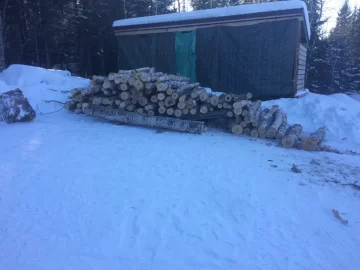

Got my first 2 cords of white birch today from a local forestry company. $180/cord, which is literally half of what it would cost had i bought it already bucked/split. This is the first 2 of 10 cord i intend on getting split and stacked before summer. Lots of work ahead. Does anyone have any tips for how they attack such a pile of wood with the saw to minimize handling. These logs are 8ft, and they are heavy. Thanks for any ideas!

Eight foot white birch is going to want to rot quickly if its not cut and split. To buy some time, run your saw down through the inner and outer bark the length of the log. No issue when its below freezing but once it warms up its important to give the water under the bark a place to escape.
IMHO just pick and end and start sawing.
yes, that's really good advice - i've learned the hard way already that birch won't last at all left like that. i hope to have that pile completely processed by March 1, so shouldn't be an issue.

oh man, i can only dream of having access to those kind of hardwoods. birch is the best wood we can get up here - also the odd stick of ash, but it's harder to come by. this is the first time that i've bought wood, and i did it begrudginlgy, but i don't have the time to go out and harvest 10 cord and get it laid up by the end of may. i think it's a pretty good looking 2 cord of logs?

Cutting a log stack into rounds is easier if you can cut a number of logs at once. I take a sledge hammer and tap the logs so that they are all even at one end. Then I measure and mark the top log of a group starting from that even end. That way you can take a long bar saw and cut down through a number of logs without having to mark each one.
Of course, it is much easier if you have laid down some sleepers underneath before unloading so that you can cut down through without worrying about hitting the ground. It might even be advantageous to lay down some sleepers on one working end of your pile and roll a group up on them before cutting.

thanks! that's great advice. I did put some pallets underneath, but those have nails that i wouldn't want to dip the chain into. I was thinking about cutting multiple logs at the same time as you do, but was concerned with not seeing the nose of my bar and getting potential kick back?
I have been cutting on this pile for about a month and I have only had one slight kickback when a log pinched the bar, as your sleepers will never be completely level. I cut one round off one end, then another off the other end, and work toward the middle of the stack. You do need to take care though.

You should do just fine. Just take your time and study each log you want to buck. Those logs look relatively small enough to be moved a bit with a crowbar.
Oh, and I would try to avoid bearing the bar tip in the next log over.

the easiest way i gound it to move them around with a skidsteer or tractor. i dig some out and put thim up on a pallet table so theres no bending over
ya i usually roll them up by hand onto a pallet table that i made and buck them at a comfortable height. these logs are too heavy for that though, and unfortunately i have no heavy equipment. Think i'm just going to pick away at the uphill side of the pile. Maybe put a pallet at the bottom and roll them onto it a few at a time.
Check out this thread. Lots of good ideas that are easy on your back.
ya i actually read that thread as it was going. lots of good ideas in there, but a lot of them require heavy equipment. i really liked that big log crib, but i don't think i'd be able to get the wood in there!

I cant speak to volume loss when splitting logs of that size, but I have to say you have way more than 1 cord in the latest delivery. With 8' log length, a 4' x 4' section with no air gap is 1 cord. Assume a 30% loss due to gaps, that's a 6' x 6' cube, and you clearly have more than that. I sale almost 2 cords total as my guess.
it's just that pile that's at a right angle to the other stuff that's the one cord. I measured it today, and it averaged 8 x 4 x 4.5 ft.

Brought the fourth cord home tonight and added it to the pile from yesterda. This load was a bit underwhelming, but i think overall i still got about 4 cord. Any thoughts as to how much wood is in this pile (just the one with the ends facing forward)? Should be 2 cords.
