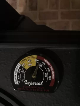

I’m posting an image of my thermometer. I got it from Lowe’s. It was pretty cheap so if someone can recommend a better one please do.

That’s a thermometer designed to go on single wall pipe. No harm with using it on your stove, if you can train yourself to ignore the ranges.
Some have dual ranges, others are labeled separately for pipe or stovetop.

The temp readings should be accurate correct?
Hopefully, but we have seen some that are off by >100º.
I've put my condar next to my rutland and they were ~87°F off.
The IR gun confirmed the condar within ~3°F.

Okay, I do not have the correct thermometer. I'm going to order the Inferno from Condar.

Its correct as far as a Thermometer. Just have to disregard the ranges like Ashful said.

The wife has already expressed concerns operating the stove over 500 degrees because it's in the overfire range. I tried to explain to her about it being a stove pipe thermometer but I thinks it's best just getting one that corresponds visually... If you know what I mean.

This is why I like my unzoned clean dial thermometer. The stove will be fine at a higher temp as long as it is under 750º. Even the Condar is quite conservative. That said, get one of these to at least end the unnecessary anxiety.
http://www.condar.com/Stovetop_Thermometers.html
