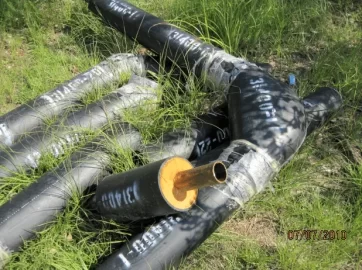

You can buy pre insulated steel pipe like this 2" steel. It was used to pipe a large ground mount thermal array. It is encase in foam with a protective layer around the outside. The main goal is to protect the insulation and keep it dry. I think the standard Armaflex pipe insulation 220F with a sleeve over it would work.
The InsualSeal PVC I have used has foam and blast hole liner over it to protect and keep it dry.

CTE foam 26x10-6; Steel 6x10-6. Polyurethane expands about 4 times faster per deg F than steel. Looks like you could foam in trench if supported and corrosion is controlled. Much like Bob's pic. I'd use pex because after welding, etc it might end up cheaper or the same. But I see no reason it wouldn't work.
BTW steel in sand very bad idea.... Very. Enormous conduction energy losses. Unless u want warm dirt.
