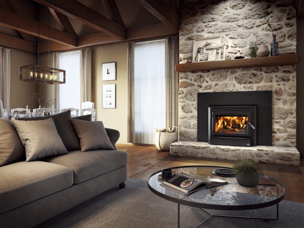

Thank you, again. I just visited an Osburn dealer, although it will take me a little more time to get a quote. I am actually not super impressed with the 3500, the way the blower kind of just sits in front of the unit kind of looks funky (IMO). Kind of a shame, because I love the size of that model. The Matrix 2700 might be a good fit, that's the one I'm going to get quoted. It's a bit smaller than the Lopi (2.5 cu ft vs 3.0 cu ft), and the quoted heating area is also smaller (2200 sq ft vs 2500 sq ft), but if it's considerably less expensive it might be worth stepping down to the Osburn.
Whether the Matrix 2700 would fit is a question. It would be tight, and I'll have to remeasure to make sure there is enough clearance for the very back of the unit. I guess we'll start with getting a quote and go from there.
