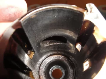

AHHHH The power of BEER Torn It down ( not a hard job) The piston is scored but the cyl is in awsome shape 1 piston and rings couple of gaskets and new fuel lines I should be back in business

Just a word of caution.... looks like some aluminum has left the piston. Are you sure the cylinder is okay as is? I just hate to see you throw a piston in there and have it scored again. Can you get some pictures of the cylinder?

Agree. Seems pretty bad...... May not be. But...........
That piston is certainly fried. Check the cylinder with a bright light and feel for any grooves. Check around the ports for scoring, as that is typically where they get it the worst. I have seen some fried pistons and rings, and the cylinders were OK though.

I put a mag light in the bore and the coating must have saved the cy. I worked in a machine shop for 4 years boring blocks. The piston looks bad I can't find 1 scar on the wall. I found the red barn on e bay and was gonna call today
Do you see shiny aluminum transfer on the cylinder wall? If so, you have to get it cleaned off.
not at all I just looked again , I think a new piston and rings I should be good
Yep if the bore looks clean, order the piston and rings and away you go!

I'll let the guru's On here check the cyl for me . Should I hit it with light sand paper and oil before re-assembly
No! Do not take an abrasive to a nikasil coated cylinder. Especially since you can't get another one!
Yah, no sanding, honing or cross hatching a Nikasil lined cylinder. Muratic (swimming pool) acid only... oil is good, I use 2 stroke oil during assebly of 2-stroke P&Cs. On 4-strokes I use moly assembly lube.

Should I give it a bath in acid and how strong should be used to prevent additional damage?
Muriatic acid is only used to specifically target the aluminum transfer.....which you don't have. So skip the acid.
Also, there is no reason to light wet sand with oil because you have no aluminum transfer(I'll disagree with the others as it works well on stubborn aluminum and will not remove the nikasil)

No need for an acid wash on that cylinder. That looks real clean. Fit in the new piston and rings, and fire it up. Make sure you tune the carb so you do not re-fry that piston running it too lean. With a clean plug, clean air filter, clean exhaust screen and fresh gas, set the H and L and idle. Most of the 009 carbs have H & L setting screws, but not all of them have H screws (supposedly some have fixed H jets). I do not have the RPM numbers for the carb settings, as I do not have the manual for that saw either.
