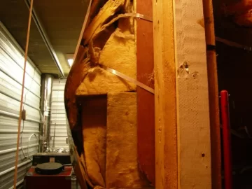

I went with just building an enclosure around my tanks then insulating with fiberglass & roxul - there's some foam board in there too in places.
I liked being able to still access everything if needed (like replacing a temp probe - or fixing future leaks if one appears - or whatever), and if I crack open the enclosure on one end I have a great radiator to warm my basement up with. I also stuffed about two coils of pex inside around the tanks to preheat my DHW with - I think that alone actually does most of my DHW heating during heating season, except during heavy usage like multiple loads of laundry.
