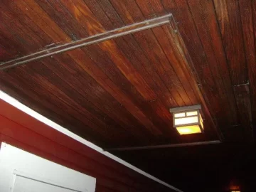

    My house had one, long gone though. Just the upper cleating is left.
    Good for you on the install Maple. Screens in the door are nice in the summer, and letting the sun in during the winter isn't bad either.
