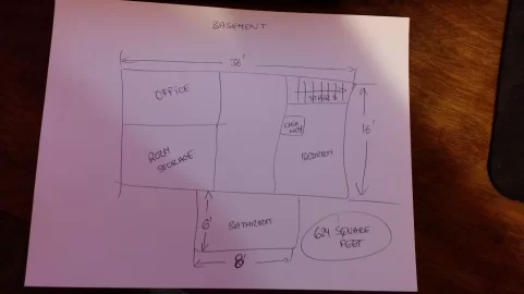

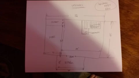

Stove are going on sale so it is time for me to buy a 2cf and up. I need your help and advice on deciding which one to get.
Please find below the layout of my house including where the chimney is.
The chimney issued that I have have been addressed in a different post. Begreen was kind enough to tell me
what to do to make the house safe.
Other factor to consider. I just talked to the energy auditor and I have a heat load of 25000BTU at -30F.
And my air exchange is at .61 air exchange per hour natural air exchange.
So now I need to find a stove to heat this little house.
Thanks in advance to all of you input and guidance
your layout didnt post
whats your house square footage.
Are you well insulated with good energy efficient windows?

where is the stove going? Basement?
The basement block walls will absorb some of the heat. So a 2.0 to 2.4 cu ft stove will do. A little bigger might come in handy on minus temp winters like this one if we ever have another one.
With insulated basement walls that would be alot of stove for 1300 square feet. The 2.9 cu ft size. A 2.0 cu ft should do you and get you a 9 hour burn time easy.
A 2.4 cu ft stove might be good if you want to over size a bit.
Remember your house is well insulated and have energy efficient windows and the basement walls are insulated.
