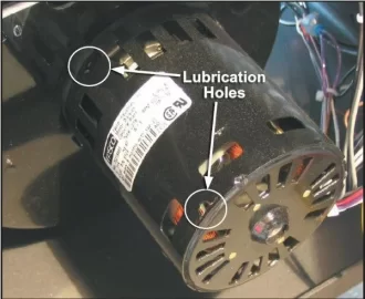

While the stove is down and cooled off alittle. Lube the room air blower. Can of WD-40 will last a little bit. But 3 in 1 oil is better!
Also check the blower fins for dust on them.
I had to do this to my bigE. Got the motor going until I had it replaced.
Hope it helps a little.
jay

DON'T go by the "once a season" cleaning advice in the manuals....the stove should be COMPLETELY cleaned after every TON of pellets. Completely open all cleaning ports, ash traps, etc, and remove panels/"brick" if possible, remove all blowers, etc, etc, and clean....especially the combustion blower...it gets ash built-up on the fins and blower body under the fins...scrape with a thin putty knife. Be careful when removing the combustion blower....try to NOT tear the gasket.
Vacuum, scrape, vacuum some more, etc....80% of stove problems are a result of a DIRTY STOVE. Lubricate motor as shown above with 3 in 1 oil, or straight 10w oil.
