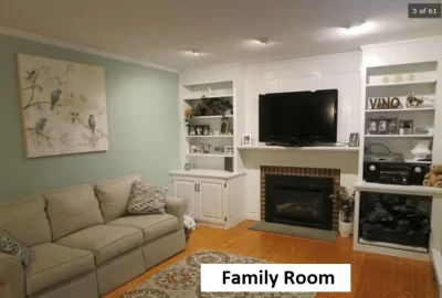

The main issue we are going to have (with either stove) is the wood facing on the sides and above our fireplace opening (see attached pic). My wife and I have decided that we want to replace the wood facing with stone veneer, because we like the look better and it solves any clearance to combustibles issues. I’m excited for the challenge of the project, but I don’t think I am going to be able to fit it in before this winter (wife is 8 months pregnant, I am in the middle of painting the exterior of our house).
I was really bummed about not having a stove this year, but then I started to think through whether it would be possible to just do the minimum necessary to make our fireplace compliant with all of the clearance requirements this year, and save the stone veneer project for next summer. We would have to tear down some of the wood facing, and so it wouldn’t look pretty for a year or so, but we wouldn’t mind it. Here are the clearance issues we would run into (with the Boston), and how I would like to deal with them. Please let me know what you think!
Depth of hearth – Need 16” from front of door. I have 18” from the wall. The Boston protrudes about 7.75” from the wall, so I would only have 10.25” from the front door. I would buy or build a cheap hearth extender, just for this year. It would be replaced when we update the hearth with stone veneer.
Depth of Firebox – This is might be a tough one. Needs to be 19”. I have 20” of depth at the floor, and about 18” at the top of the Boston (~20” high). However, since I am adding stone veneer, which will probably be ~2” thick, that additional standoff will increase the depth of the firebox to 20” at the top of the Boston, which would meet the requirement. In the interim, I was thinking of framing the opening of my fireplace with some non-combustible material (see pic), that would function like the stone veneer will, to increase the depth of the firebox. Does this make sense? Is there a non-combustible material that you would recommend for this purpose?
Facing on the sides and top – Since our facing protrudes more than ¾”, I assume it is treated in the manual as an unshielded side wall (sides) and as a mantel (top), instead of as facing. I will probably just cut out all of the facing on either side of the fireplace opening, and above the opening up to the mantel.
I believe these are the only requirements I don’t meet right now.

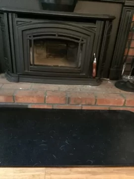

I think the depth of the firebox is not an issue. That measurement is what you need to make the facing line up tight against the existing brick. Without it, you will just extend one inch further into the room. I don't think anyone will notice. I have a little gap and it looks fine and increases the circulation of air which is a good thing.
However that does put more pressure on the front. You really need to make sure that you adhere to the 16 inches. I have 8 inches from the door and then use a cheap $100 extender. The top gets hot but the floor under stays cool. My hearth is raised a little so it's probably even more important for you with your floor level hearth.

NGASN, thank you for sharing your experience, and a pic. Letting the insert stick out a little bit would definitely be the simplest solution. I wasn’t sure if that would be considered a violation of the requirements or something like that.

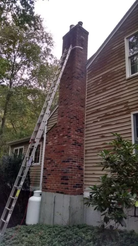

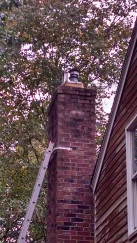

So now I’m trying to figure out what liner to get. I’m 95% sure the exterior dimensions of my clay flue are 8”X8”. I need to get up there and measure. My chimney is about 22 feet tall from the top of the flue to the bottom of the fireplace opening (this is based on estimating. Haven’t gotten a good measurement yet). My understanding is that an insulated, double-wall pipe is the way to go, but from what I’ve read on this thread: https://www.hearth.com/talk/threads/my-install-in-progress.163448/#post-2195088, I won’t be able to fit an insulated, 6” chimney liner down an 8x8 flue. Does that mean I’m stuck with a non-insulated 6” liner? I’ve attached some pictures of my masonry chimney.

Thanks! I'm not sure if that would fit though. With my ladder fully extended I could just barely kinda sorta reach up and measure the flue dimensions, so I'm not sure this is right, but I measured 8 inches as the exterior dimensions of the square flue. If that is the case, the inside is probably something like 7"x7", or even smaller.

I'm an idiot, but a happy idiot. When I kinda sorta measured the flue dimensions from the ladder, I was only able to measure the basement flue. They both looked to be the same size to me (8x8). Apparently my estimating skills are poor. I finally was able to get up on the roof, and measured the flue I will be using for the insert. The outside dimensions are 12x12. So I should be able to fit a standard 6" liner with blanket insulation no problem.
