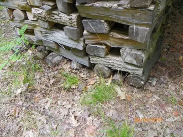

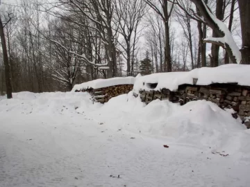

    After the wood is split (now it can start to dry), we stack our wood on poles (saplings) that we cut in the woods. Lay down two and stack the wood on them. In a pinch, I'll even lay down some small rounds or even splits to stack the wood on. The big thing is to get the wood off the ground and allow some air under there. Notice in the picture below that the bottom is just some maple saplings we cut in the woods. Gets the wood up and allows some air under.
    Of big importance is to know your friend and that friend is wind. This is how the wood will dry. Sure, sunshine is nice but not necessary. Many times we stack wood in the shade and it drys very nicely. Air circulation; your friend.
    Now you need time. You also need to know there can be a huge difference in the amount of time your wood needs to dry properly. For example, you could cut some soft maple in March, split and stack it right away and it could be ready to burn by fall. On the other hand, you could cut some oak at the same time and be cussing it 2 years later because it is not dry enough. We give oak 3 years before we attempt to burn it. Ash is a big one now because of the damage of the EAB. Ash is a low moisture wood to begin with so it can be ready to burn in a year. But as of late, we are getting some ash that does not need a year because it has been dead so long there is barely any moisture left. But please pay close attention to the wood. Fuel is needed for the cars and fuel is needed for the stove. You want good fuel in both.

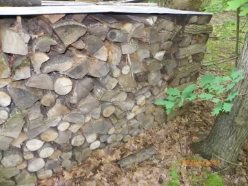

    This is how we stack our wood. Crib the ends and when done, we cover the top with old galvanized roofing. Remember that when you cover your wood, it is important to cover only the top of the pile. Remember that you need air to dry the wood. If you cover it all, where will the air circulation come from? btw, we do not cover our wood that first summer but usually cover before the snow starts to pile up.

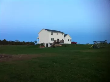

    Let's see if I manage to upload my first picture...The flue will be installed on the corner of the house closest to the walk out basement door. I don't think we've decided what wall, but I'm leaning towards the end of the house with no window. Will it matter either way? The wind comes from the direction the picture was taken.
    Thanks for all the input and info! I'm trying to soak it up like a sponge, but it's comforting to know I have some very knowledgeable people "close" by, when I do mess something up.

    Amazing the info in this thread alone. The nice picture came up fine. I can see why its windy, and why you want to heat with wood. Be well

    Although my preference is to run it up through the interior of the house it looks like you'll be fine running it up the end of the house. The only complication will be going through the soffit overhang. They'll either need to cut it or do an offset to get around it.

    btw, nice house and I see what you mean about windy. Good part, no trees to block chimney!
