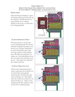

Any thoughts on the Woodstock Survival Hybrid steel stove. It says it heats a small space ( ~1000 ft^2) and costs $1349 ( with the $200 discount)
It’s a wood coal combo stove, which is very unusual these days

That's an intriguing thought. It might work. I've only read about it and it sounds like it may need to burn coal to achieve a dependable overnight burn. Wood capacity is 1.2 cu ft. I'd love to try one of these out in a small space. For a longer burntime a Fireview or Keystone might be a bit better fit.
Reading the blog.. the problem with coal is that the burn efficiency drops significantly ( form ~80% for wood to ~50% for coal)
They designed the coal part for the coal available on the Navajo lands ( which i read as a soft dirty coal). The drop in efficiency is to better meet the soot specs
Attached is a thumbnail of the airflow for both coal and wood

Read it when first published. 1.2 cu ft of fuel is what it is.
