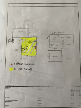

I’m new to this forum and for the most part wood burning. My wife and I decided now is a good time to purchase a wood stove for the main part of the house. We live in a 2500sq colonial on Long Island NY.
We currently use a traditional fire place in our step down den. After consideration of installing an insert in the den we would not benefit from its radiant heat. It’s a small room on back corner of house with a small doorway.
With that said. We have an open floor plan on the opposite side of the house approx 1100sq’. We will be putting a stove here. There is the master bed and bath above the stove as well as an open stair way to the second floor. We like the upstairs on the colder side 65 in winter. We’re not looking to raise the temperature tremendously up there. I know being directly above the stove the master will see an impact of our new addition. I’m told by professional installers a medium stove is our target. My house was built in 1976, has new windows and R-13 insulation. We are a young family on the go. I would say the stove would be our main heat source for the most part. It better be with the investment we are putting into this.

Attached is the layout of my house.

Before constructing anything, make sure that the stove permits a clearance reduction and list that in the manual. If it is not in print, it is not permitted. The Rockport does permit this. With an NFPA 211 wall shield the rear clearance can be reduced to 12". To reduce the corner clearance below 9" it would be best to get written permission from Travis (Lopi) with the specific minimum allowed corner clearance with NFPA wall shields.
It looks like you will be ok with about a 2 cu ft stove. For stoves that qualify for the tax credit (now capped at $2000), in non-cat look at the Lopi Evergreen. In catalytic, the Rockport is a good choice. A BlazeKing Ashford 30.2 or 20.2 would also work well.

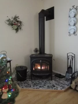

I also have a fireplace in a back family room and decided that the better bang for the buck was on the other side of the house in the corner of the living room / dining room L - we live in a 1970's colonial. I do have a VC Dauntless (flexburn )and I am having no problems with it - once I got the hang of getting the fire started:) We are also new to wood stove heat - using it to have emergency heat if needed, but mostly to keep the house more comfortable in winter. We light it up in the evenings. However, my stove + install was a little more than $7000, though I will be getting $2000 back this year with the tax rebate - you won't get your rebate till you file your taxes for the year you bought and installed the stove. On top of that was the cost of building the hearth - you can buy a hearth pad but I opted to build one and the various extras - ash can, wood holder etc. I had one area of my yard that worked as a wood shed, but it is not big enough so I will be enlarging it next summer - another expense:) We did not add the stove to save money, though I'm hoping some of the cost of firewood and starters will be offset in lower heating bill. We very much enjoy the added heat and secure feeling of having a reliable, off grid heat source.
Even though this install is to code, I do find the wall with the plates on gets a little warmer than I'm comfortable with right by the stove. I run a fan pointed at that wall which keeps it cool and also blows the warm air out into the room. I plan to build a small heat shield for that area.
I have that exact stove and that exact material for my hearth base. This is in an expansion Im putting on. I did not raise my hearth. Wood flooring will run next to it level. What are the odds?
