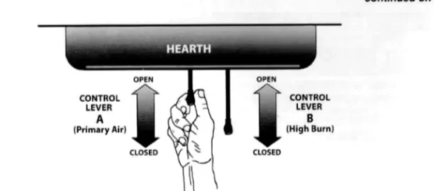

After the fire is started, both handles all the way out is minimum burn, all the way in is maximum burn.
