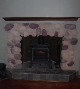

Well here is the almost finished product, its tucked into the corner, I still have some cleanup (STONES ARE VERY DUSTY) to do, sealing and shining of the stones and slate, but overall, I like the look of it, and the house is staying real cozy.
