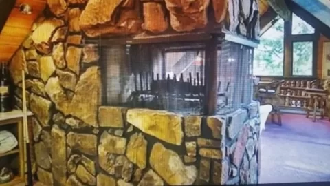

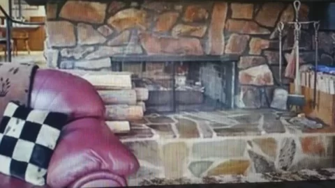

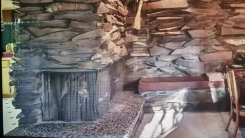

Fireplace 1- Length= 48" , Width= 41", Height= 21" (Open on 2 sides lengthwise)
Fireplace 2- Length= 48", Width= 24", Height= 26" (open on 1 length and 1 width)
Fireplace 3- Length= 37", Width= 30", Height= 22" (open on 3 sides, both length and one width)

it doesn't look like the opening for fireplace one is tall enough for even an insert. Most inserts are taller than 21 inches. This is one example, but all of the inserts on this web page are taller than 21 inches. (broken link removed to https://www.rockfordchimneysupply.com/osburn-wood-burning-insert-1100.php). If you went with a free standing stove then you would have to find one with a rear exhaust hole.
For fireplace #1 there are a few that will squeak in around 20" I think. The Lopi Answer (20 3/4") Enviro 1200 (20 3/4") and Country Striker 160 (19.5") come to mind. It will be tight so measure thrice. Fireplace #2 has the opposite problem. it's taller and narrower. The width is an issue. This fireplace might be better off with a freestanding, rear-vent stove on the hearth. Woodstock has some stoves that will clear this lintel. Fireplace #3 has the most options. Take a looks at the Enviro Boston 1700 and see what you think.
