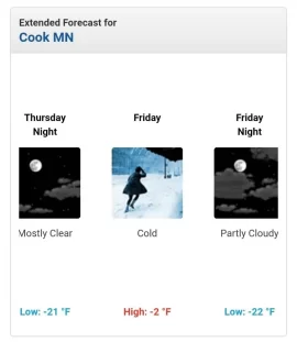

Climate where im at is quite cold, not unusual to see a couple weeks where it doesnt get above 0 f., is it a bad thing to run a bigger stove with smaller fires?
