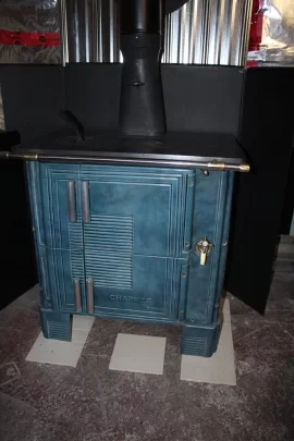

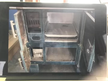

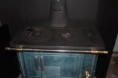

Just to give you an other thing to read , I send you some photos showing what we got for what my wife thinks could arrive one of these days , not survivalist but she wants to be ready ifffffffff... It's a small French antique cookstove, but we never used it after 3 yrs, and maybe will never use it but ifffffffffffff. Installed in the patios basement, btw, we took 1/2 of the patio 16 X 10 for the small living room and the rest became a smaller patio 16 X 10 instead of 16 X 20 initially. So the patio basement is 16 X 20. The height of your chimney should also be considered for your application and maybe a safe thing to ask to your insaller is how he will do the installation. Again , sorry but I can't avoid it : 8 X 10 is one of the smallest room for a wood stove = 80 sqf, my small living room is 160 sqf and it's considered very small, so make the right choice with the smallest stove you can get.

What a beautiful set up that is and I know you get really cold in Canada and that piping is so tall on the outside and would not all the heat go up a cold pipe and be bad--just asking...That stove is really pretty and different and is that a oven type of deal on the right side and a firebox on the left---don't know its pretty though and just a wonderful size as well...Need to look at your dimensions again and take time to figure for at 75 my brain works slow and now I try to get my original thread on here--I am very bad with computers and it is #37 posting for the two pictures of my back porch..

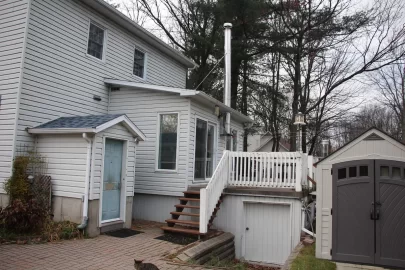

The chimney is for the small living room and is install acording to the Canadian code, so this chimney is for the little Squirrel. Because the Hearthstone Heritage in the living room heats the entire 3 floors, the small Morso was in for **emergencies**, for ambiance fires and also a little for fun, at 70 we must have some fun and wood fires are so good for that. Let me tell you that the Squirrel does all that and much more. I was also wondering if we could have down draft on a cold outside chimney ( we never had with the other stoves ) and with a so small stove but I especially lit the stove on cold chimney and small fires cause the stove is new, but no down draft not even fume from the first flames, the top/down method is the best for starting a cold stove on a cold chinmey. Yes it's an oven on the Chappée cookstove. As said before, the place is 16 X 10 and we would never have installed the cookstove in there. That said, I want you to believe me : I don't want to direc you on my specific installations, stove ...but just want to tell you to take all your time before to pull the trigger( I thing that you say so in US). Re-read all the good comments here from all the members. Bonne chance du Québec.

That's a cute stove, but I think it's for coal.

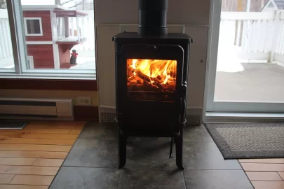

I'm on my fourth fire today with the Morso 1410 and believe me , I don't sell stoves, I tried many in the small living room, YOU choose the one you like the most but for us the Morso is the best one , easy to lite, easy to control the fire, and for the air knobs, only the upper one is functional. The lower one is for Eropean places when burning anthracite/coal, here it's welded so you only work with the upper one and I was amazed how easy that knob does exactly what you want to control the fire , small wood is so fun to work in the Squirrel.

One more thing to care is the stoves footprint in your place and then add the distances to combustibles for the codes.
The Jotul 602 V2 = 12,7 X 21.25 inches
The Morso = 15 X 14.5 inches , almost square
