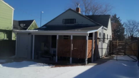

Yea you are right SpaceBus and I am trying to design that space now so that I will have some ideas for the carpenter to consider and see if he can do it but one consideration is I am worried for it to be next to the main house wall (worry wort here) and of course its the installer who will call this but you are right and it would save some money. I am also looking at your suggestion of the brick work to get the price down and I am looking at that too as well. I have a South wall next to the driveway that has a lot of wind to where sometime I have to leave the front fence open because the wind there is like a wind tunnel or something. Then I have the West wall that is the lowest height and this faces the yard and the next wall North is where the back entrance to the house is with a wall on the right " coming out of the house "that is the wall to where on the other side of the wall the basement steps go down..I put three pictures on here but it did not work so I need to figure out how I did it before because I forget...lol...clancey and I will work on it...getting old...

That was a struggle but I got some old pictures on here so that you can see it better..Please forgive the mess and it won't look like this when it is done---I hope...Is wind good for a wood cook stove if not that driveway wall will be out...Thanks for the help everyone clancey

Sitting thinking about this stove and wondering how long that double piping has to be is it with this stove and how far from the walls does the stove have to be set. I might have to put it on the wall to the main house because I do not want it to be such a high profile to begin with and more blend it with other things on the roof. The high point I guess is about 95 inches and as another poster said these stove pipes would have to be about 14 feet and if I do that then I have (about 7"9 under the roof and 6".1 inches above the roof and that's the high side.
My figuring could be off here because of materials that finish everything including a 4 inch concrete floor. Does the pipe have to 14 foot on this Morso 1410 because 6 foot outside seems like a lot of pipe and do you think I might be able to shorten it or is this standard.. Does wind affect these wood burners or maybe it might be good some wind but sometimes lots of wind on the other side of the porch--wind tunnel.. I am just thinking about all of this so I thought that I would ask...Does it have to be straight up can it be sideways going out the wall...Just wondering....thanks -some pictures in the before posting with some prices..thanks..clancey

The chimney exit must also be two feet taller than anything within ten feet of it. I find wind makes the stove run harder so I have to close the air controls sooner, but every install is different. Some people report no changes with wind. My cookstove is a rear vent stove that has a chimney that goes right out and up the wall. This is a more expensive install since the whole 24 foot flue is all double walled insulated Class A chimney pipe. Our Morso is a top vent stove with single wall connector pipe going into our masonry chimney. In your case the least expensive way to do it is straight up and out of your roof. This will be less Class A Chimney and more double wall connector pipe. I know sometimes tall chimney going out of a low roof looks a bit funny, but smoke pouring into your house because the chimney is too short is even less funny.

That makes me feel a bit better and I am thinking of "how to design" where it is to go on the porch. I really need the installer here to walk me through a few things but its nice to know that it is possible to do. Thanks for the encouragement and I needed that so off I go to cause havoc in the world..lol Thanks a lot...especially about that download button and I will try to use it when I post and see if it works for me..clancey Wow it worked----thanks..
