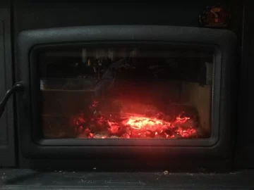

To start with, last night I loaded about 80% full at 11pm (northeast, temps were in the upper 20s). I then when through the chokedown process, etc. until it appeared to have a nice secondary burn. I got up at 7am and I had a hot bed of coals. the temp on the thermometer was reading around 275.
I then added 4 splits, medium size - about 7-7:15am. I never opened the damper. I left it fully closed. It lit within 2 minutes and developed a nice secondary burn within 10 minutes. Thermometer got up to about 560 degrees.
This video was taken at 8:05 am about an hour later - The damper remained fully closed.. Temp has dropped to around 500. Im not sure, but i feel like its burning way too fast and not just from the secondaries.
This next video was taken at 8:24 am - Fire is just about out, temp has dropped 80-100 degrees in the span of 20 minutes.

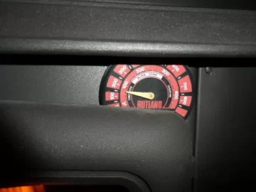

The picture attached was taken at 8:55 am. Im not sure if you can read it, but the temp is down another 80-100 and right about 300 degrees.
As of 9:22 (no pic) temps are under 300 and reading in the creosote zone on my thermometer. So this is where I am at. in the span of apx. 2hours, I am down to under 300 degrees and could feasibly re-load the stove.
Doesny anyone have any ideas what my issue might be? At this rate, I am going to blow through my wood.

How far into the burn did it take to get to 560? Did it get higher than 560? If not something is wrong, and what I see in the pics, is you still have a good bit of wood in there.
If the temp is dropping that soon, I agree the wood is not as dry as it should be. I would get at least another 4+ hours of burn based on the second photos worth of wood.

the highest ive seen it go is 600 and didnt hang there for very long. it hits around 560-600 within 20-25 minutes of loading it up. once i choke it off and kick the blower on it drops to around 500. it stays in that area for as long as there is a visible flame. once that is gone, it goes down to 300-350. does the blower affect the temps?

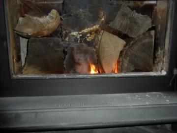

Here is my reload I just loaded. I have had it fuller with less air space, but it seems to be a little milder tonight. And I did a little earlier cause I didn't pack it full at noon today.
I won't reload till noonish tomorrow. On milder days I can wait till even later and still have plenty of coals for reload. Box temp is actually 150 at this reload, a little cooler than I like, but I it happens.
Keep in mind, a stove is not like a furnace, you will have temp swings anywhere from 3-5 degrees or more depending on outside temps, wind, tightness of house etc.
These are things we have to live with, its not a set it and forget it thing.

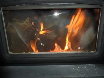

Okay since I was lazy and reloaded at 150, you can see after 15 mins, still 150.
Just starting to burn. My fault for loading at low temp. Also loaded with wood pulled off the outside pile this evening, so prolly has some residual moisture in it.
Just set the timer for another 15 mins.
I personally set the oven timer eery reload. The times I don't, sure as shat, I get involved in other things and forget about the stove. Not a good habit to get into, and don't do it very often. Did today though, another reason I didn't get the full 12 hours out of this afternoons load. For me, timer is a must, unless your babysitting right there in the stove room the entire time after reload.

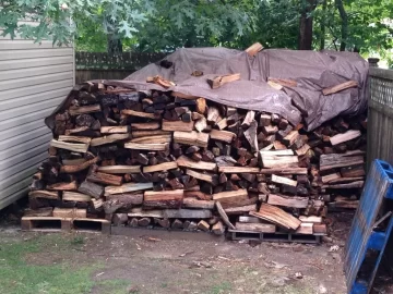

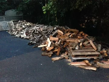

Im not 100% sure what species I am burning. I know its a mix. Attached is an image of a typical load. Occasionally there are some bigger, thicker pieces...but this is pretty average. Also, the wood looks wet b/c its raining out and just brought it in. Also attached is a pic of the 5 cords I had delivered around July. It was claimed to be seasoned, but you know how that goes.
As for draft - since my wood isnt 100% dry, I will get a little smoke with I open the door if there is a few pieces in there that havent lit yet. Not much at all though. However, if its coals or burning, i get no smoke at all.

here is a clearer picture of the wood once i stacked it. its not a pretty stack, i know. im a newbie and i have since cleaned it up and set the tarp up better.

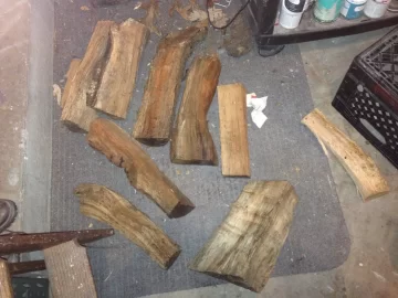

so can someone ID what Im burning? Also.... are my splits too small? Compared to Hogwildz load, my splits seem like they are a lot smaller.
It looks wet....... Looks like what mine does in spring when I cut it.
Tough for me to tell the species from the photos. Think I see some Maple in there.
Those splits in my opinion, are mostly smalls, and very thin.
By appearance, some of that stuff looks fairly freshly split. But I am going on what I can see.
Are you left with lots of unburnt coals at the end of the burn?
Not so sure on 5 cords, but tough to say given limited view. What is the length x width x height of the stack?
Try digging out 7 or 8 of the largest splits you can find, load the stove full on a nice hot bed of coals and see how that performs.
I have a feeling your issue is both too small of splits and less than dry wood.
4 of those splits will not last very long, but the stove should still reach higher temps with them, just for a shorter period of time.
If it doesn't then I suspect less than dry wood.
Maybe one of our Long Island members can pony up a stove load of good dry wood and see how that performs.
Those splits are way too small for full time heating. That is the stuff they sell to campers around here.
