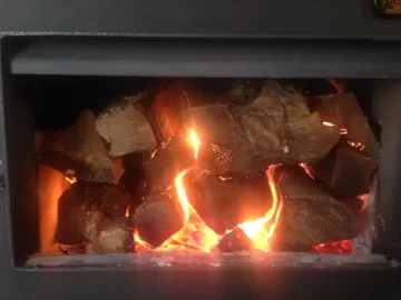

Here it is now at 11:49am. Fire is out, down to coals and they arent completely burning, so I opened the air intake. temp is also down to 315-325. I will need to reload within a 1 to 1 1/2 hrs.
Looks like you are making progress. FWIW it took me a month or so to learn to run this firebox well so that I was getting longer burn times. But this year I have poorly split wood that I bought to support a local boy scout troop. My burn times are erratic and I can't wait until I start burning my personally split hardwood.
This wood load still looks loosely packed and while better, it had some medium to small splits in it. Pack it tighter next load, with more large splits and small splits filling the gaps. Skip the small splits on the bottom if there is a good coal bed and load it fuller. Say to within an inch or two of the baffle.

unfortunately, those were above-average sized splits. Except for the stuff on the bottom. I dont have very many really large splits. I am also not sure what species any of it is.. if you look up in the thread, you will see i have a few pictures of the wood. its a mix of stuff the landscaper gave me.
the wood was packed as tight as i could get it. its looks loose because what you are seeing is an hour into the burn with a lot of the smaller stuff 1/2 to 3/4 burned down. i probably could have add 2 maybe 3 more smaller splits in.

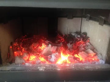

ok.. here is the coal bed I was left with. Temp was down to 300. i probably couldve gone another hour or so, but for time consrtaints, i needed to do it now.
picture one is the coal bed i am working with.

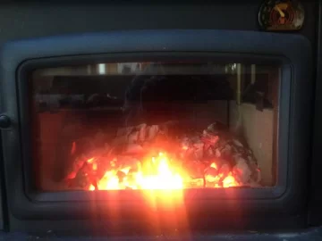

Picture 2 is the load. it instantly ignited, even as i was putting them in. i may have been able to get 1 smaller piece in the top left corner. the pic is a little deceiving, there really wasnt much space there at all.

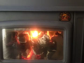

this is it now, 10 minutes later. the thermometer hasnt really started to move yet, but its blazing. at what point do i start shutting it down? when the temp goes up or when it looks like that?

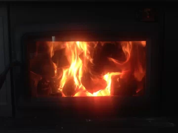

i choked it off about 5 minutes after the above picture....and we have 650!! this is by far the hottest its ever been. its so hot, that i think its baking the paint again. it has the same smell as when i burned for the first 1-2 times. i had the blower off and kicked it on. im assuming the blower will bring the temps down? with blower on about 50% its stable at 600.
Burn the coal bed down further by putting a couple small, skinny splits on top and opening up the air halfway.
At this point the air probably can be shut all the way down. A hot coal bed ignites dry fuel quickly.

Every time you hit a higher temp than ever before, the paint will cure/bake a little more, and you will get that smell of curing paint. This is temp, and not an issue.
When you get it down more, it will go to 700-750, and you may want to put the blower on high for a couple hours until it settles in.
