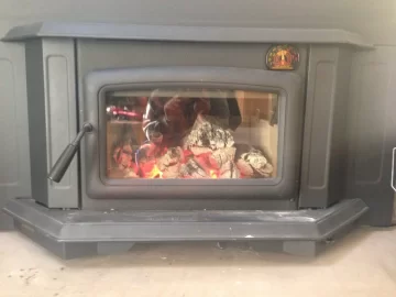

this morning I got up around 6am and got the stove going from a cold-start. I added a chunk of duraflame, some bark and a few very small, light splits. I got the stove up to around 450 degrees and got a decent base of coals. At around 7am I then packed the stove out... I put the smaller stuff on the bottom figurinh it would catch quicker and get the bigger stuff going. I didnt snap a pic of the load right when I put it in...stupid.
The first pic is at 7:58am. The fire was just getting really good. Stove temp had dropped to around 400 during this time and started to creep back up. Probably close to 450 again in that pic. You can see that there is a good 4" or more gap between the top of the wood and and baffle. The smaller stuff had already started to break apart within that hour.

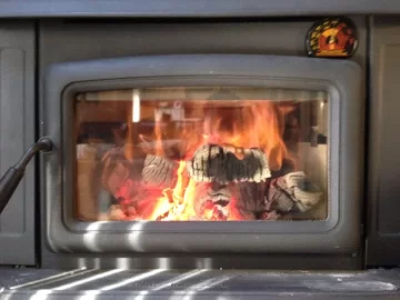

The 2nd pic is 9:52am. The middle splits were starting to breakdown. Stove climbed to 500 and hung there for a while (maybe 1 1/2hr). I had a good secondary burn going as well.

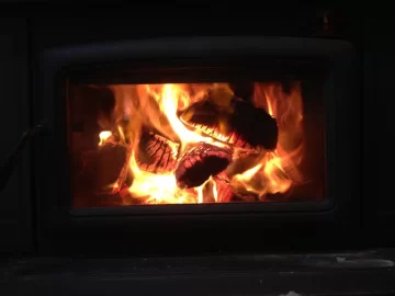

The 3rd pic was just a few minutes ago at 10:49am. Im left with a lot of chunks and its burning very slow. Temp has dropped down to about 460.
My great room went from 65 degrees at 6am to 74 degrees at 11am.
