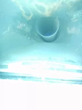

The tag says it's a superior zero clearance fireplace Model: B(?)36. The house was built in 1980 and the questionable second character was only stamped hard enough to show what appears to be the top 25% of an "8". The damper was completely missing when I bought the house. In the attached picture, the 8 inch inner flue pipe is sitting on the top of the back metal heatshield. I'd like to connect with someone who has familiarity with this fireplace to figure out a few things.
1. Is this actually a Superior B836?
2. How was the inner flue originally attached to the top of the unit?
3. Was this fireplace designed to accommodate outside air?
Any first hand information would be very helpful. I've yet to find anyone local who doesn't see me as anymore than an $8000 sale.
Thanks in advance. Max

The fireplace could be a Superior BR36 although I am not sure if it has been around that long. Maybe it was installed later. A pic of the front would help for identification.
The flue should sit on top of the unit and be connected to the flue collar. It looks like it is protruding into the firebox? Have you measured its diameter? Maybe someone used the wrong pipe. If yes, that would certainly be an unsafe installation.

It does sound like you have a BR36. The inner liner would have been attached to the unit above the damper. Since the damper is missing, I'll bet there was a Woodstove sittinig in front of it with a pipe shoved in there at one point in time. Or possibly an insert, if so more parts are probably missing. A good picture would be nice.
