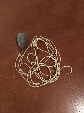

One tool I don't go to work without is the plumb bob. Just a 5 foot piece of white kite string with a one ounce steel weight tied to the end.
A great way to tell which way the tree is leaning, I wouldn't crank up my chain saw if I didn't have my plumb bob.

The plumb bob with the white kite string is just a great tool. It is so accurate and easy to use.
You sold me, I can see how handy it would be. I made one for cutting tool box. I used 6 feet of kite string and a fishing cast weight.

You look at a tree, and you can pretty well figure which way it is leaning. Or, so you think.
Then, get your plumb bob, stand back maybe 50 feet where you can look at the entire height of the tree against that bright white kite string. You can see perfectly which way it leans. Or, some of them, don't lean at all from that perspective.
Then walk 1/4 of the way around the tree, so that you are 90 degrees away from the first spot. Use the plumb bob again.
I am pretty good at cutting down big trees, and about 1 out of 5 I am wrong when just eyeballing. Plumb bob doesn't lie.
