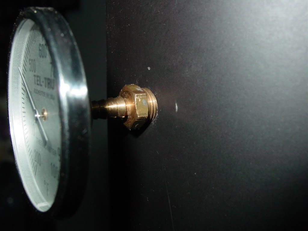

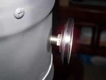

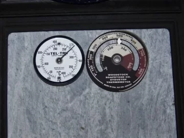

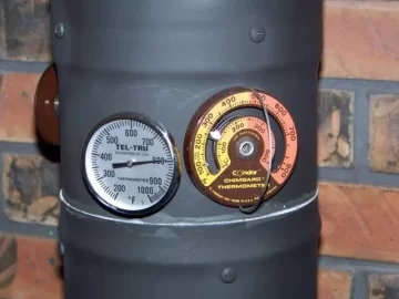

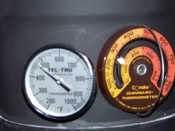

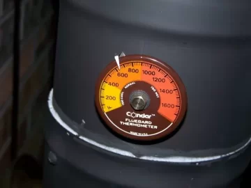

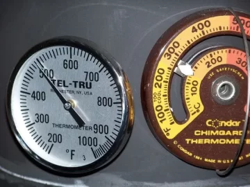

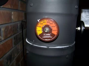

Just received my new Teltru thermometers and thought I'd share some observations. I bought the Teltru GT225 2.5" stem, 2" dial probe thermometer and wow, does it ever react fast! 1st picture is with the stove in bypass with lots of flame in the box, the temps shot up quickly to 600 then I backed down the air to #2 and the thermometer instantly backed off down to 300. I played with the air setting for awhile and brought it up as high as 800 then backed it down to 600 and engaged the cat. Also observed the Condar probe and surface thermometers which lagged way behind the Teltru.
