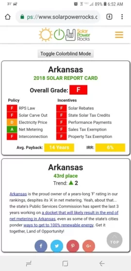

Just curious but with .09 kwh electricty cost in Arkansas your payback must be like 15+ years? Arkansas is ranked 3rd for the cheapest power in the US.
Here in New England the payback is usually 5-7 years with some of the most expensive electricity in the lower 48. Most of us are paying .21+ a kwh. Here in CT we pay the same as Alaska! Though we do have the some of best solar incentives.
This is a great site to compare incentives and payback time.
https://www.solarpowerrocks.com/state-solar-power-rankings/
EIA electricity prices.
https://www.eia.gov/electricity/monthly/epm_table_grapher.php?t=epmt_5_6_a
Yes, in fact 15 years is exactly the ROI on my system. I’m hoping it still operates a few years after that date!
