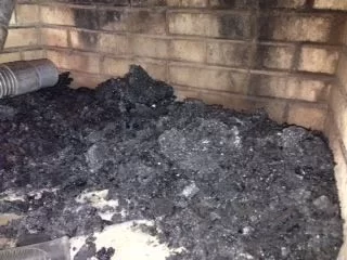

A month or so ago I posted about my first chimney fire. Today I was finally able to get the chimney inspected (I did not use the chimney in the time between). Bottom line up front: WOW. The damage was extensive! Multiple cracks throughout the length of the chimney tiles. But the most concerning part was the state of disrepair the flue was in. I bought the house in July. The home inspector said the chimney was good to go. Apparently the previous owner (my father in-law) never had the chimney swept. The guy doing the cleaning vacuumed up over 20 GALONS of creosote build-up. He came in with a 30 gal. vacuum and had to stop to make sure it wasn't completeley clogged. The cleaning and inspection took over 5 hours. I am so lucky I didn't burn the house to the ground.
A word of caution to everyone out there, rookie or veteran, have your chimney inspected and cleaned AT LEAST once a year. Never trust the opinion of someone who does not specialize in that field.
This has been an expensive lesson, but it could have been much worse.

Your insurance company should pay to have the chimney relined it is fire damage. And once a year is a good general rule but that depends on how much you use it. There are many open fireplaces that we do once every 5 years and they are usually not very dirty then either. There are also a few we do multiple times a year so you need to figure out what works for you with how much you use it
It sure could have ended much worse, good thing you did not take the advice of those that would say a chimney fire just "cleans her out good".

20 gallons? Holeey crap!
Reactions: alforit
the worst one I have cleaned so far was 65 gallons. That was a nightmare cleaning they were really lucky they didn't light it off because it would have been a blast furnace of a fire.
Thanks for the update and sharing.
Only way to enjoy wood burning is when it's safe. Glad to hear you are on your way to being there.
I would get my money back from that inspector
No one should ever trust a home inspector to inspect a chimney unless the have a camera to scan it (which I have never seen one have) There really is no other way to inspect the inside of a chimney correctly. In my experience most home inspectors really don't know enough about chimneys to give an evaluation.
Reactions: n3pro
Really to the op I am glad nothing bad happened really. Some cracked liners really isn't to bad they may have been cracked before this fire as well. Now just submit it to your insurance and get it fixed right it should work much better with a good insulated liner in it anyway.
