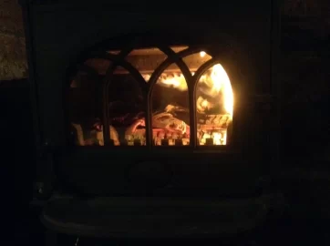

I'm not sure if this has been a feature of the stove right from the start (one year ago) and I'm only just noticing it, or if this is a new thing...
I am noticing that the fire is burning a little unevenly. The right side of the box always burns more slowly and also has fewer secondaries.. Sometimes the darker appearance of that side of the fire is quite marked, with no secondaries or flames at all on that side.. Other times it's not that bad. When I think about reloading, I sometimes notice that the coals are glowing red and pretty much spent on the right side of the box, but they are still black in parts on the left side. Also, there is almost always a sooty stain, just on the top rear left corner of the fire box, whereas the rest of the box is clean.
The air secondary intake (Jotul F3cb) is on the rear left side and the air control is on the front right. The uneven burn seems to be happening at any stage in the cycle.
At first, I wondered if it wasn't so much that the left side is under-burning, but that there is a leak on the right side and its burning more energetically... but I don't think it's that, becuase of the slightly under-burnt coals I sometimes find on the right side towards the end of the cycle.... Nevertheless, i tried the dollar bill test and the result is just the same as when the stove was new - the bill slips out after a little resistance all along the top of the door and does not come out at all from the sides or bottom. My first post here a year ago asked if this was OK and I belive it was considered a pass.
It's not a HUGE thing.. The stove is performing OK generally.. I guess I'm kinda hoping you might say that many stoves do burn a little unevenly...I'm sure I half recall seeing something written here to that effect, but haven't been able to find it in a search, so maybe that's wishful thinking...

Yes..I tried the dollar bill test and the result was just the same as when the stove was new - the bill slips out after only a little resistance all along the top of the door, but does not come out at all from the sides or bottom. My first post here a year ago asked if this was OK and it was considered a pass. You may think otherwise, but as far as I can tell there's no change from last year.
Here's a pic... It's not always as bad as this, but it is often like this when the air is almost entirely shut off and the secondaries kick in. When the stove is open and blazing before that, the imbalance is less apparent but still there if you look for it.
I think I may have been the one to give it a passing grade. It still sounds good.
Logic would seem to be "more incoming combustion air" in that area. But why? I don't know.
Has the top ever been off the stove? If so make sure that it got put back on correctly. It is easy for it to hang up on the little set screws. If that happens, or if any crud is on the gasket it can leak air on that side and cause uneven burning. Take a look at the lid in comparison with the stove body from each side and make sure the lid is parallel to the stove body.

Ok.. So I hate to say it, but it does seem that there is still a problem. I really thought that adjusting the stove top did seem to make a wee differenc, but having now sat with it for a few days, things seem to be pretty much as they were - the stove is under burning on the left side, especially in the rear, in both the flaming and the secondary burn parts of the cycle.
Here's what I have noticed in total so far -
1- there is a small deposit of soot always present on the left side of the rear secondary burn holes... Exactly at the point where secondaries rarely happen.
2- there appears to be a gasket at the back of the stove box that runs between the top of the back baffle and the secondary burn plate. It is almost pulverised and it doesn't run the whole length, it stops dead exactly at the point the soot deposit starts.
3- there should be four bolts holding the secondary plate in place; two in the rear and two on the front, on the sides. They are absent.
4- in the F3 manual there is a picture of the secondary plate in situ and there appears to be a gasket running along the side of it, between the plate and the side baffle. These are completely absent in my stove.
Some guys from a diffent stove centre from my (bad) installers came round today, I pointed out what I had noticed and showed them a video of how the stove looks when burning (from which the pic at the start of this thread was taken). They said they could not think that the missing gaskets and screws would affect how the stove burns.... Even when I pointed out the co-incidence of the rear gasket stopping at the very point the soot mark begins. They seemed adamant they could not figure a way this could be connected.
The guys rubbed their chins and looked around the stove for at least an hour before they left, having re-seated the stove top (again). They said to contact them again if there was no change and they would try adding the screws, gasket etc, even though they didn't think it would make a difference.
Any thoughts? I'd love to especially hear if any f3 owners out there could take a look inside their stoves and see if they have the screws and secondary plate gaskets I've described. For sure they are in a pic in the manual, but of course sometimes these pics are outdated or generic and not relating to a specific stove - so hearing from other f3 folk would be welcome..

I'm looking at it right now - just 30 mins after the last load up - and there are perfect secondaries on exactly one side.
So, then, what is the temperature on both sides of the top?
What if, you used wood 1/2 as long as usual, and built the fire on the side of the stove that usually doesn't burn? That might tell you something interesting.
Temp on the left side is currently 150::F less than temp on the right...
To get the fire to produce even just a few secondaries on the left side I need to take the right side up to 600 before I close down the air. This can often mean the right side continues to climb a little too high for comfort.
What tends to happen currently is that, once the right side has burnt to ash the left side burns a little more and continues to burn till its done... This usually takes another hour. It's like the stove operates in two shifts, one half ata time! Hard to predict from that what would happen if I set up a fire and burnt only on the left side, but for sure I'll try your suggestion, clr8ter..,as you say, it might add a little piece to the puzzle. thanks.
