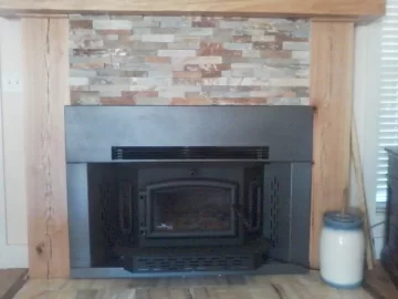

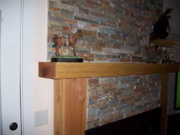

To Continue: I went with the High Valley 2500 in a ZC cabinet [click on the photo to see a larger view]
The High Valley 2500 replaced one of the fireplaces
I made the wood mantel & up-rights from a tree out back, they have dried and opened up some

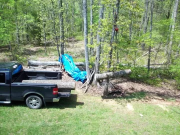

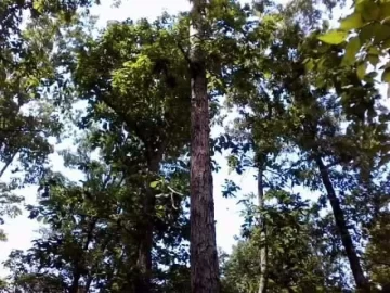

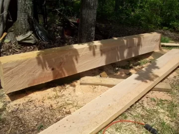

I made a mantel out of an Oak back in the Spring
I watched it sway with no leaves back last winter during high wind, it was a little to close to the house so I took it down
[Hearth.com] The Installer Recommended...

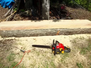

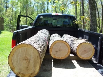

took the two short ones to a saw mill for a perfect cut to fit the stove, they asked for $20
I cut the top piece with that little Homelite; my little saw with a used chain seemed to cut the straightest with not much chatter; may have had something to do with ripping the log a opposed to cutting it.
A sharp chain did not do as good

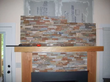

I took the uprights to a saw mill for a perfect cut to fit the stove surround and the cut-out in the hardwood floor where the tile goes
the wood has since dried and has some nice cracks giving it character (see first photo)
I have used this stove twice, the first time 2 weeks ago and again today; it did a fine job heating, my wife said "it's ridiculously HOT in here"
we have 18 foot ceiling in the living room/kitchen
the AC return grill is up near the top in front of the stove, it's a big one. There are 3 others returns in the back rooms, I sealed them off and turned the AC fan on and the whole house will get to 65 - 68 degrees depending.
The only problem I have with this stove is the side glass gets black in about 1 hour.

Good looking oak mantel! You are a man after my own heart, making an oak beam with a chain saw. I have done quite a bit of that.
Agreed. Looks Great!
Thank You Gentlemen ,
it was a labor of Love
on the mantel with the fresh wood,
the key was wearing out several sheets of 120 on a palm sander followed with alternating coats of Minwax Clear Polyurethane
