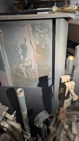

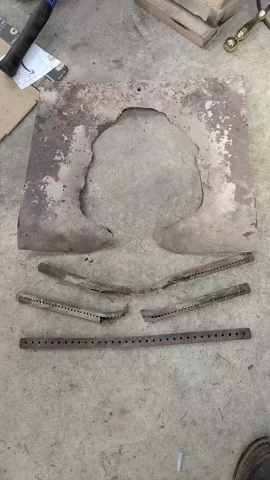

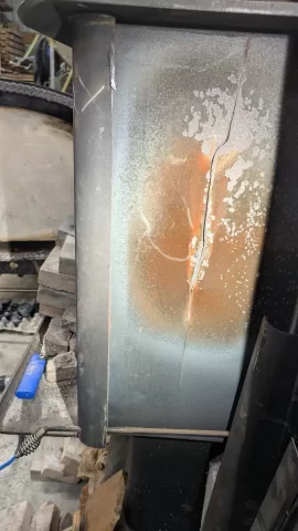

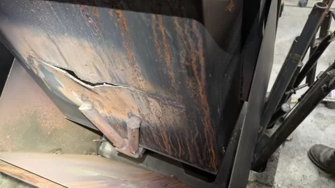

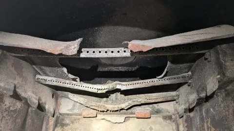

I pulled this stove out of a double-wide. It had been used as the sole source of heat for many years. The latch no longer functioned as each part was so wallered out, it couldn't get a grip on the door frame. The firebox had full-height cracks on each side, and a full-width crack across the back. The baffle leaves me baffled. Two of the secondary tubes are as bad as the baffles. The old lady was still using it daily! !!!

I had a heck of a time wrestling the baffle out of there too. It's width had effectively stretched in those "floating" corners. I've never seen one turned into a toilet seat before. That's a lot of missing steel! It's got to be 3/16" plate originally--at least. I didn't measure it.
Looks like it was run without firebrick too. The whole heater is toast, why disassemble it?
