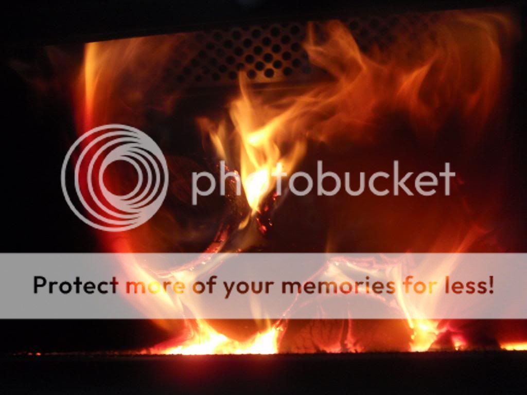

I set the dial to about 1.6 for the night.
I am still amazed that what would last a day and a half in the 1450 will now last me 3 days.
